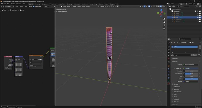

So I am in the midst of unwrapping this sword. Would anyone be willing to look at my blender file and give any pointers if this unwrapping attempt with each separate sword piece is bad? Thanks!

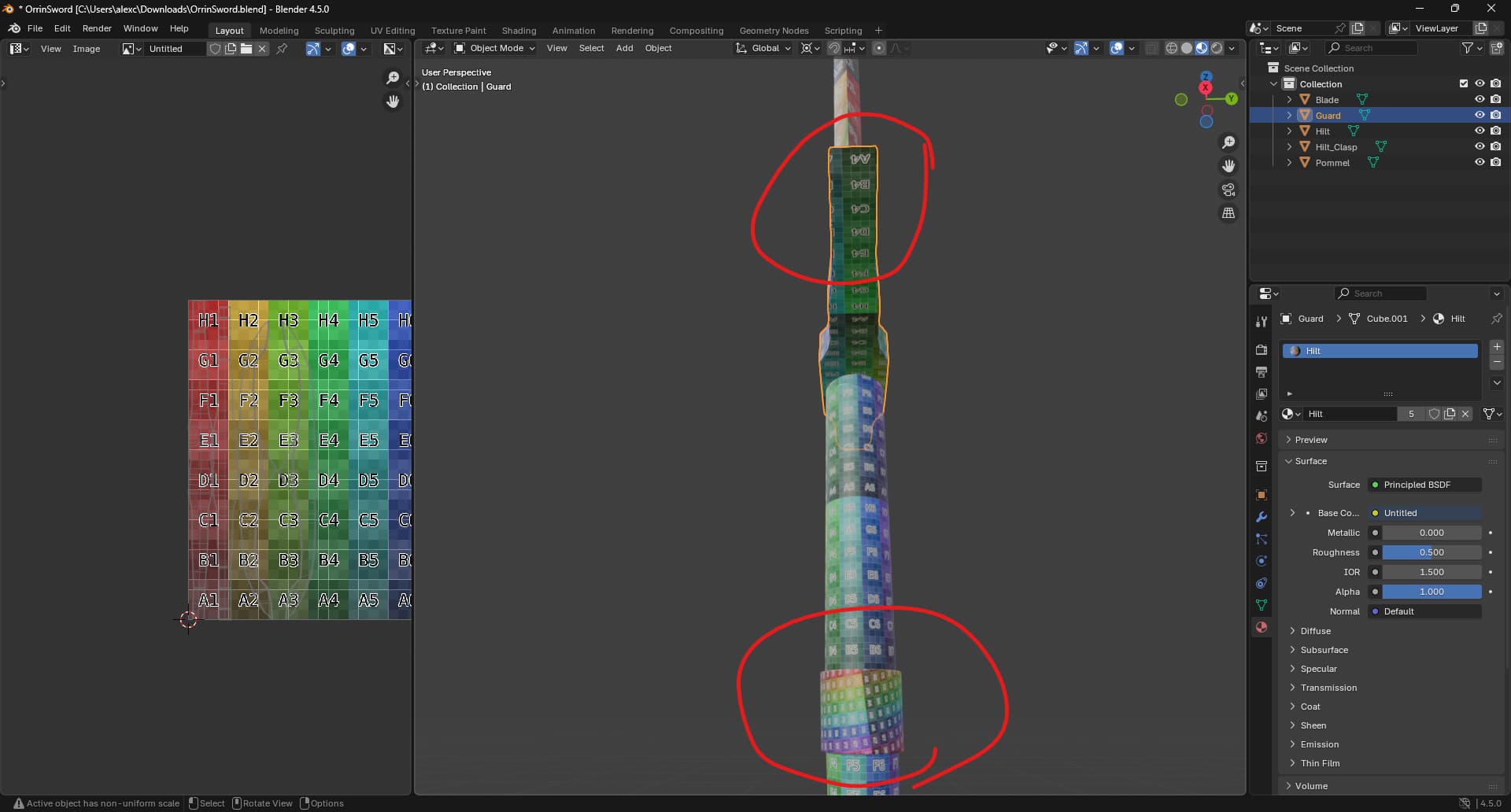

Updated .blend is at the bottom. You’ll want to use a colorgrid as that will give you better results to see. As you can see, it is currently stretched:

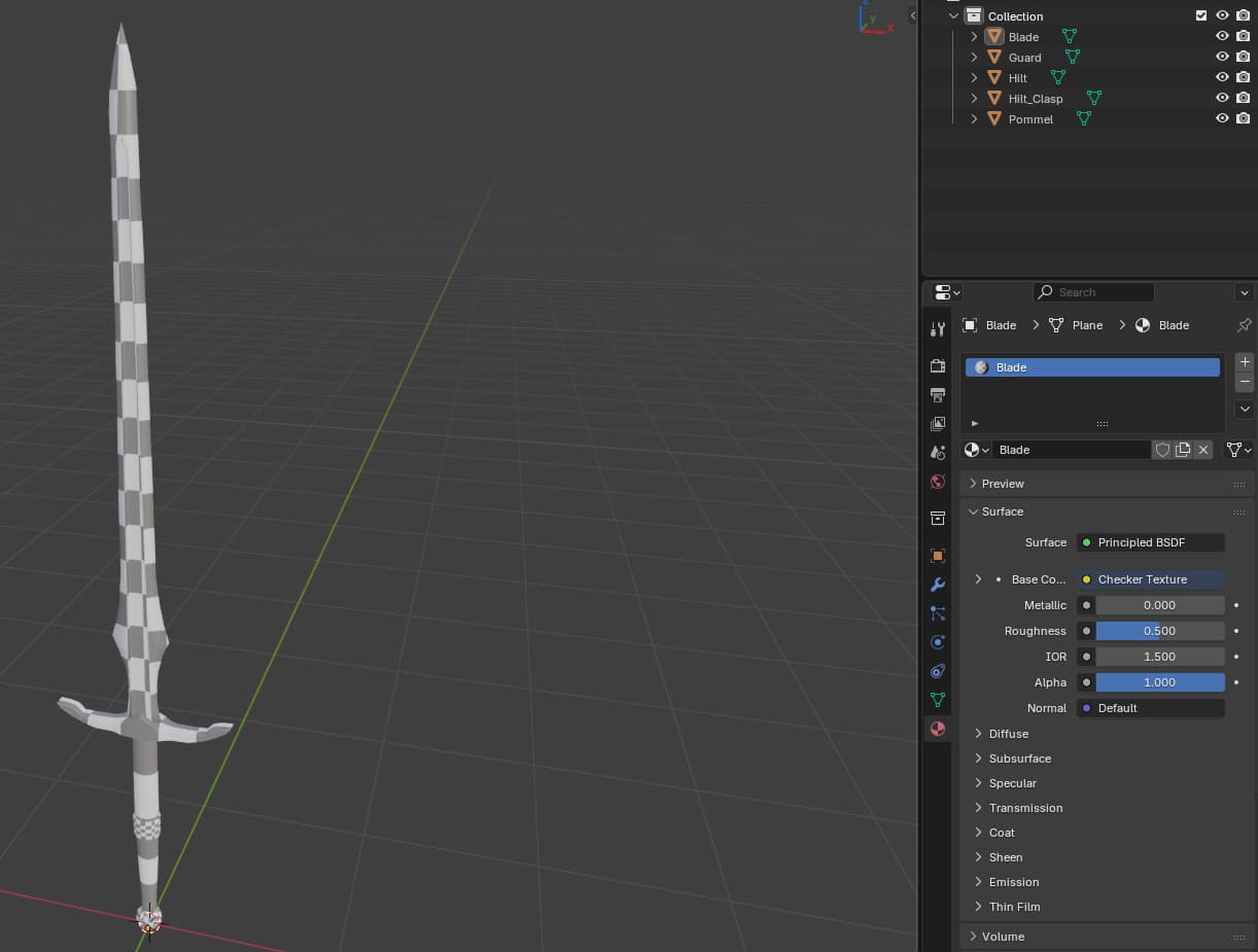

Also here the unwrap pinches the ends of the sword hilt here so it’s better to unwrap it like so and same with the cylinder part. (below screenshot is the updated unwrap) The rest of the sword looks great! Well done!
