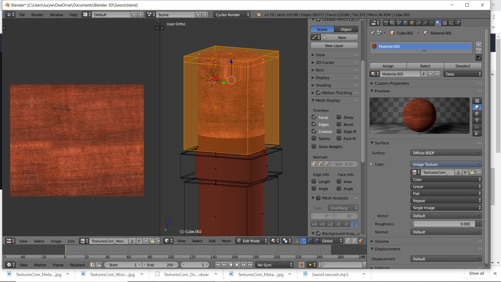

Ok me again with yet another problem. So I want to put a material on the boxed area only but (I’m assuming this has something to do with either subdvision smoothing or loop cuts) I’m only able to fill part of it. How do I fix this (in comparison I’m having the opposite problem with the rings, they cover part of the boxed area)
Hey Shayde! Yes for it to fill the whole box area you need to add a loop cut on the bottom part of the box. So CTRL+L and then slide it all the way down
LMK if that helps
