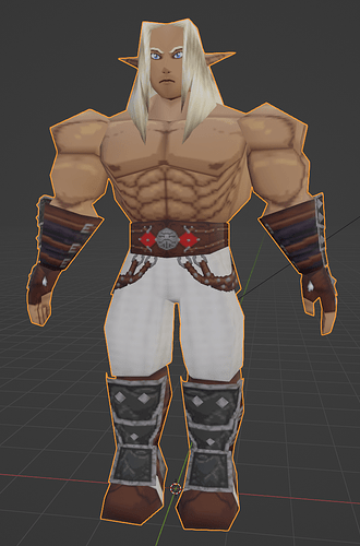

Update on how the project’s going. It’s going slowly, but I am doing all textures from scratch, so it’s to be expected. However, it has progressed nicely, to the point where the Phase 2 aspect of the plan is nearing completion! Phase 3 is when things will really get customized and personalized!
Ryo’s development has continued! Every part of his model now has textures to it! From head to toe, he’s got his symmetrical parts! This means he’s ready for Phase 3! He’ll be getting his asymmetrical parts modeled to finish his overall look! Here’s his progress thusfar:
